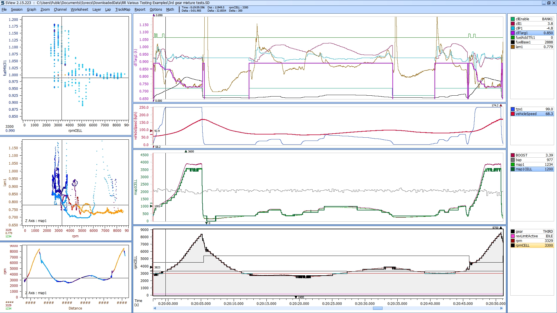

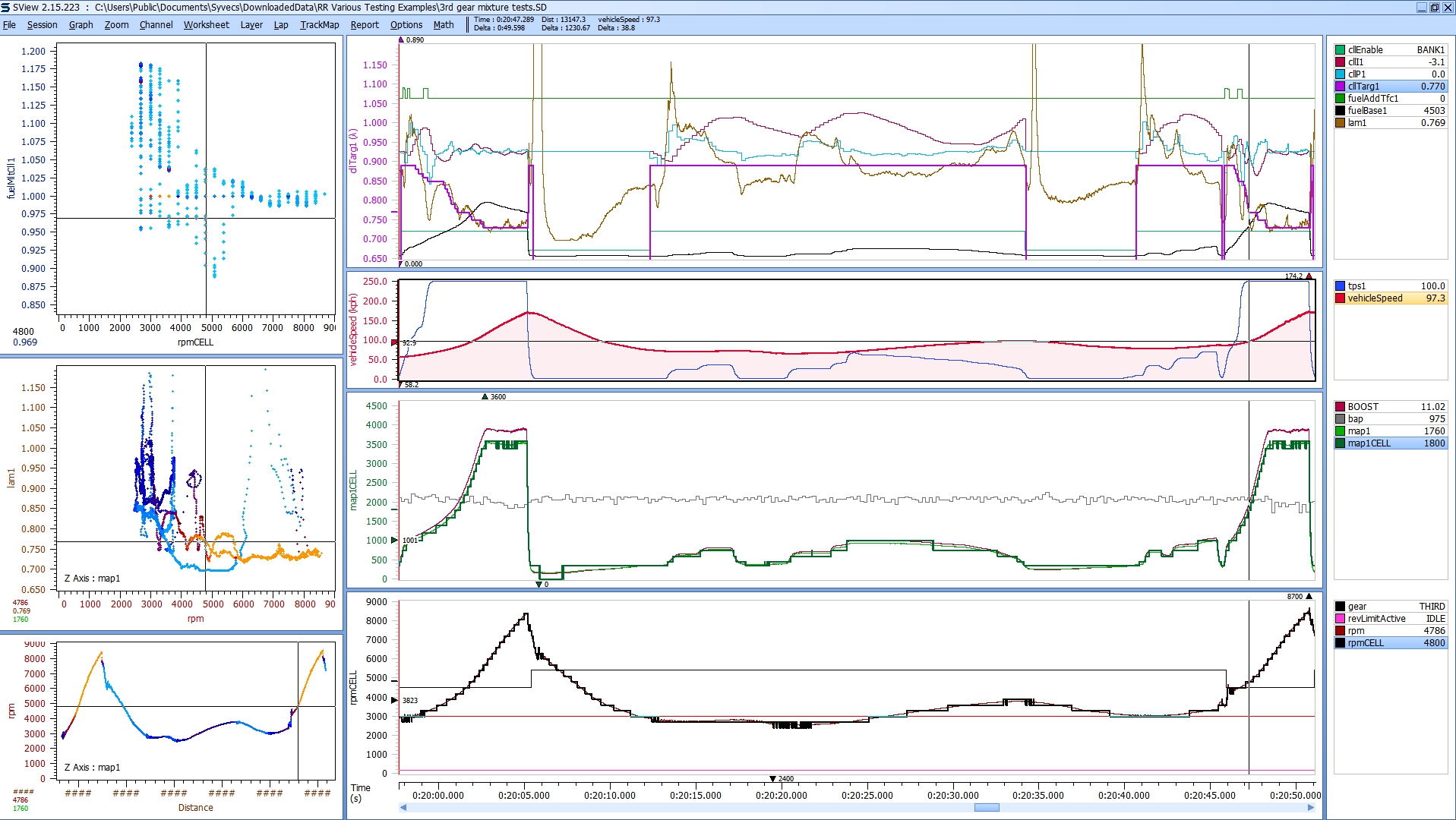

Here is an example of it not changing regardless of what rpm you WOT from,
Same gear, same end rpm, one starts at 3300rpm other 4800rpm.
If you are more specific then can suggest what to look at but suffice that there is a stack of things to look at which would influence it and cause you to have different readings.

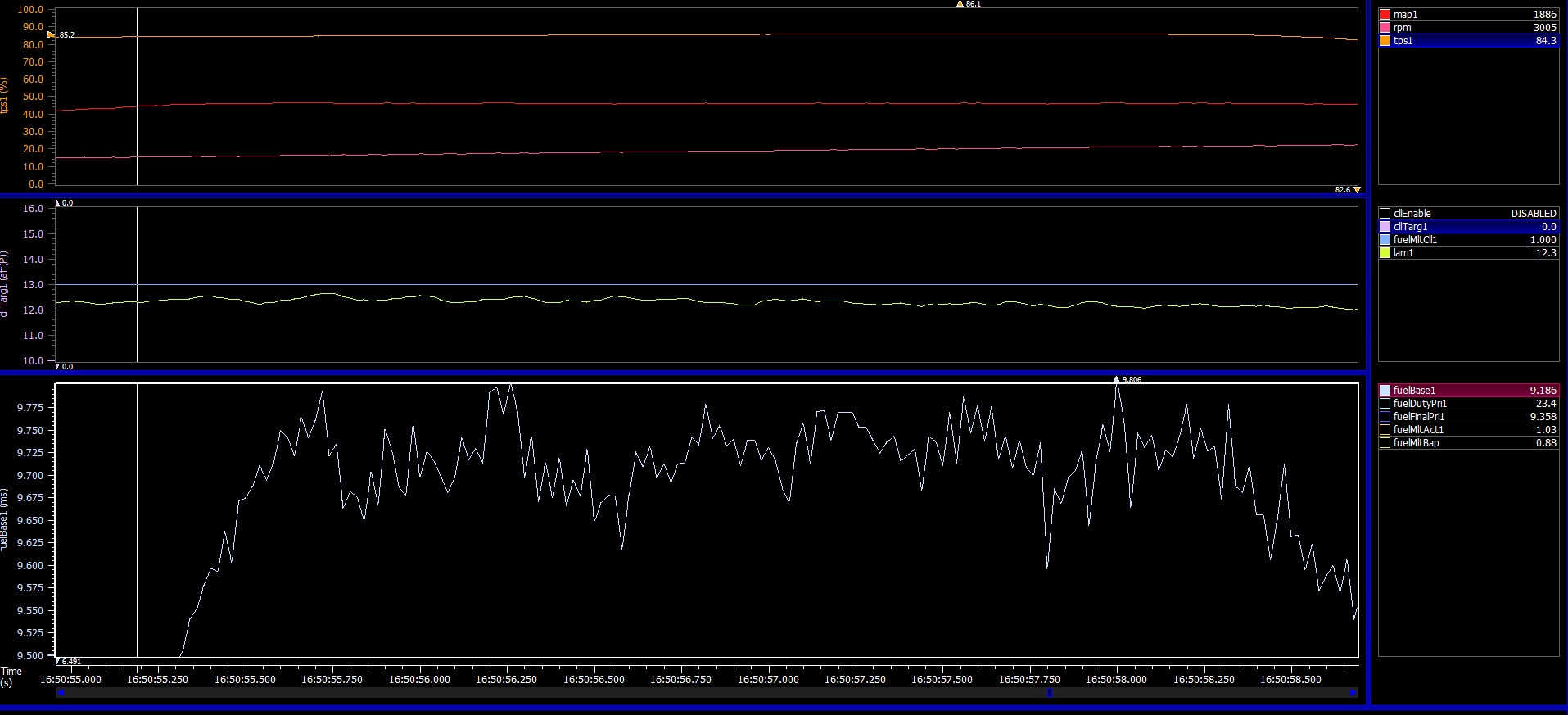

Do you use boost compensation per gear? I actually couldn't find a good log to show. I stopped my last tuning session as I felt some oddness. My AFR is lumpy, jumping 12.3 to 12.7s at WOTs. Logged datas seems fine to me. I decided to flow test my injectors but they turn with good result.

Why do you think you have alternator problems ? Seems fairly steady to me ?
And what does "felt some oddness" mean ? Certainly a misfire will cause erratic readings, although the rpm trace looks super smooth
Not really following the query though ? And although AFR is a little uneven...don't think it's of any real concern ? Although even loading it up at low boost I'd probably want it a bit richer, and closed loop is inactive ?

The oddness is lumpy AFR but it is not related with injectors so why it is?
Normally my AFR was super smooth +-0.1 AFR but my latest logs shows around -+0.5 difference.
Okay this may not be a big problem but i think it needs further investigation as it may be a fueling problem per cylinder.
My latest logging data shows 0.359 ms differences @ fuelfinal1.
fuelbase1 seems smooth and fuelmltcll1 is steady at 1.000
So I couldn't understand why it adds-removes fuel at final. I am missing smt or I am paranoia =)

Fuel closed loop multiplier stays at 1 because closed loop is off.
If you think some corrections are causing the changes....log all the corrections ?
Does it do the same thing on regular fuel ?
Also a little odd that when it transitions from CL on to off.....the CL target drops to zero ?
Although an extreme representation...fuel base is also fairly up/down for the area shown....so whatever mapping is in those cells could be smoothed a little ?
logger RPM is very stable, logged MAP is very stable...so why is fuel base a little up/down ?
