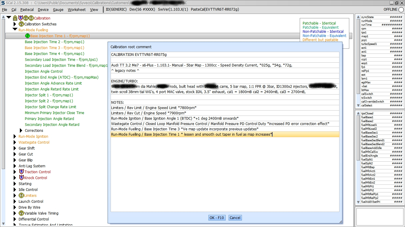

Pastecal load (the last version *with your cal notes*)
Then if you molest any given table, simply import back the prior saved cal table to your point in time where that table was correct.
Doing an arbitrary relative in time line points is well just that, the idea once anyone does hundreds of these dare I say thousands of calibration updates is documentation of the changes you do, if they are significant to justify an incremental nomenclature ratchet up then it should be documented and as such its a saved cal version, any nominal or incremental steps on dyno or road in real time will as Stevie says be there when hotspots are displayed, and if its going the wrong way and you want to start again with a validated prior version then you refer to your last saved. Simply importing this map assuming its not restricted (there is only a few of us who work with different ID's) then is really simple and the system works great.
For anyone interested I can show them how I do it if this helps? Its not uncommon to have 'hundreds' of calibrations over the development cycle of a customers car and being able to quickly and easily do what you have asked above is not only important but it is there and ready for you to use.
Maybe the picture below will help rather than words
