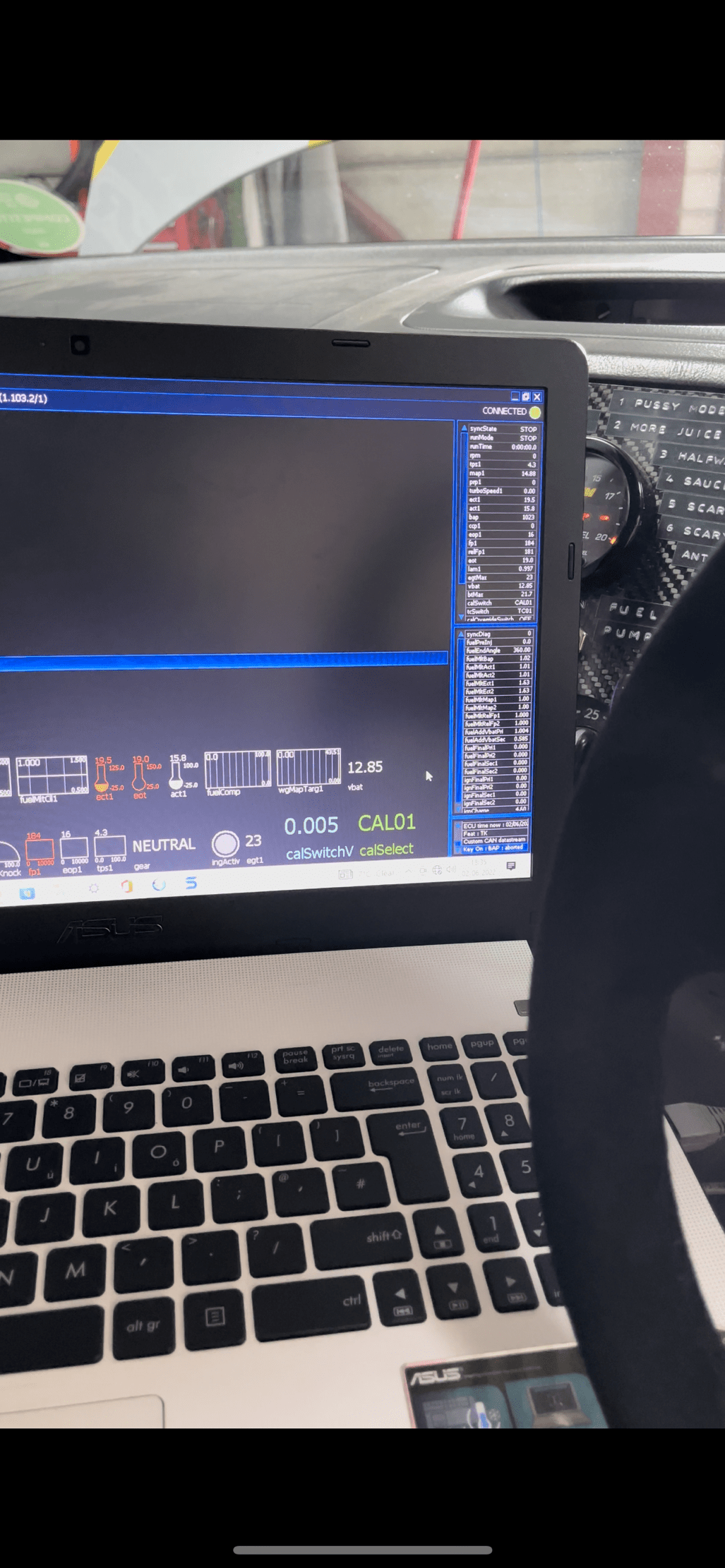

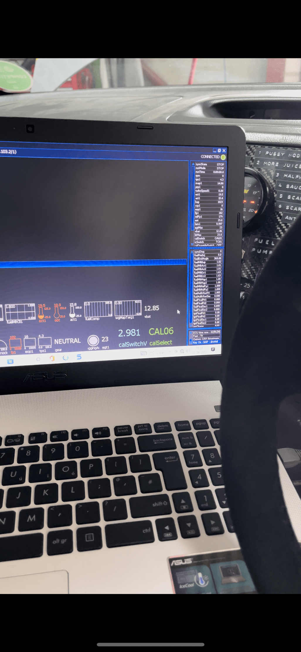

Thankyou for the responses, much appreciated, I thought I’d update you with what I did, I went with the momentary switch grounding the signal wire to the ecu, this did exactly what I wanted and I’ve altered the calibration in cal 1 to suit. I’ve added some screen shots below, apologies for the poor quality but I think you can make out the cal switch voltage and cal on screen.

- Here is with the button not pressed on the current cal 6 on the rotary switch
- 2591D18A-87C7-4FEE-B29B-0B2BFAA0386E.png (721.58 KiB) Viewed 58361 times
- Here’s the cal 1 override with button depressed
- 97C28726-25AB-4006-8FCD-6C09153D9B87.png (741.01 KiB) Viewed 58361 times

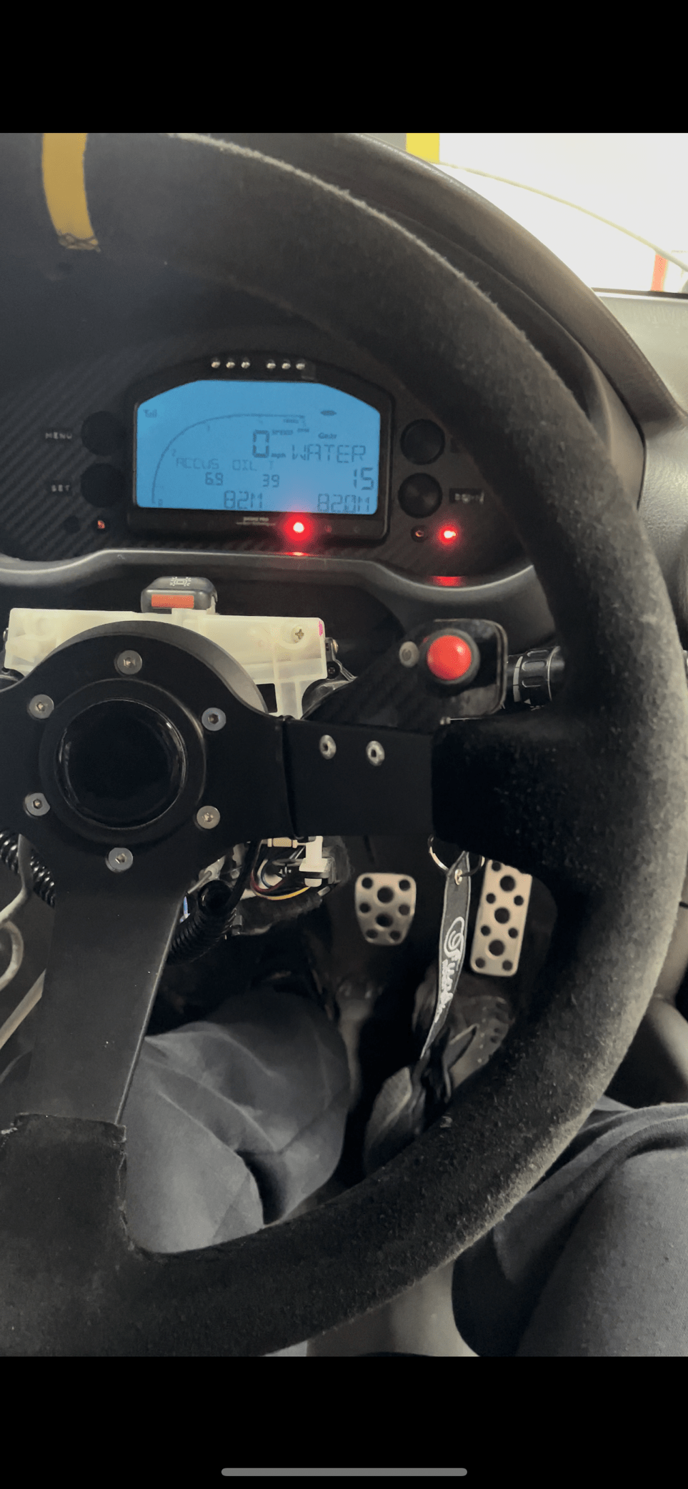

- Here is the scramble button on the wheel
