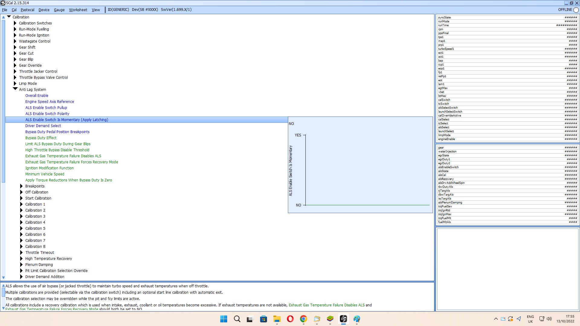

Requesting information for baseline setup for ALS system activation only. Working with a S12 ver 1.657 on Lamborghini Gallardo. The customer is requesting a momentary switch only & not using the Multi-Posistion switch for ALS activation. This ALS is only being implemented for the pop/bang noise effect. I currently have the Momentary switch wired into pin 33. We do have a Multi-Position switch in the system currently and it is working properly. Please advise on the proper software setup to accomplish this....Thank you!

Thanks for the response!....To clarify the situation the software is currently configured for a multi-position switch, it is working properly in this mode. The owner wants it off of the multi-position switch and on to a momentary push button (as the only activation of the ALS system).
Yes.. I am trying to describe "momentary" as non latching push button.
The owner of the vehicle is only looking for the sound effect of ALS, as a very temporary push of the throttle in neutral. My request is guidance to the proper software/hardware settings to accomplish this...(only activating the ALS system on/off with the momentary) As I stated above the momentary switch is wired to pin 33 (Input) as a ground (Low) & is setup as ALS Enable switch. The timing/fuel setup strategy I can handle no issue. Thanks again!

If you only want ALS active while the switch is pushed, you can use a momentary switch without issue. The software doesn't know the mechanical construction of the switch.
If you want a press/release of the momentary switch to turn it on, and a second press/release to turn it off then, as has been said, you won't be able to do this.

Yes, this is the intended strategy - press & hold the momentary switch to activate the ALS then release the momentary to deactivate the ALS.

Ahh, that makes more sense then.
So you just want it active while the button is pressed and actually held down manually ? Effectively the person is doing the latching.
Then yes, that is totally doable, just have ALS active via the switch. Of course it also means this is the only way it can be active....although I guess if you wanted it active at other times for longer durations you could have another latching switch in parallel with the momentary switch
Re: Anti lag hardware/software setup
must admit I'd never looked for a switch as an option, but it does give the option of both a latching and non latching in the setup. So all options can be covered.
In various cal select I just have it enabled as desired, and it's always enabled in "overall enable"
