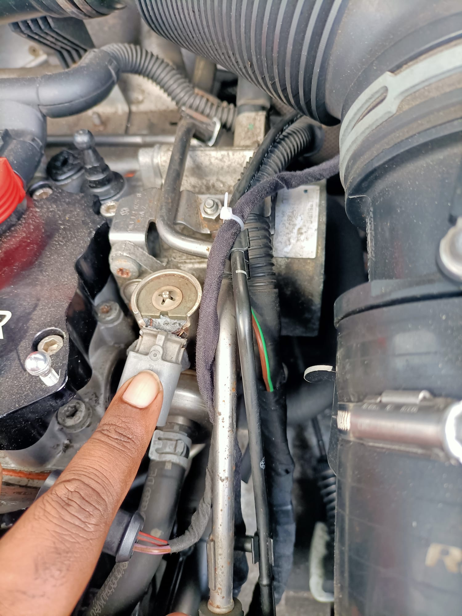

Hey im running the SGDI-TSI on a Passat CC 2.0 CAWB
I am having trouble with the DI pump using the basemap sent by syvecs I get a very lumpy start up with DI pressure max when driven at 0%
and if running in that state for around 5 mins the DI pump overheats resulting in alot of smoke and plastic burning smell and the connector no longer attached to the DI pump see picture attached

- IMG-20230215-WA0015.jpg (291.54 KiB) Viewed 35785 times

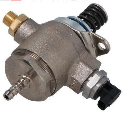

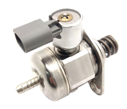

open pump looks like this used in the CAWA and CAWB engines pump part number: 06H127025N closed pump looks like this used in the CCTA CCZA CCZB engines pump part number: 06J127025L:
