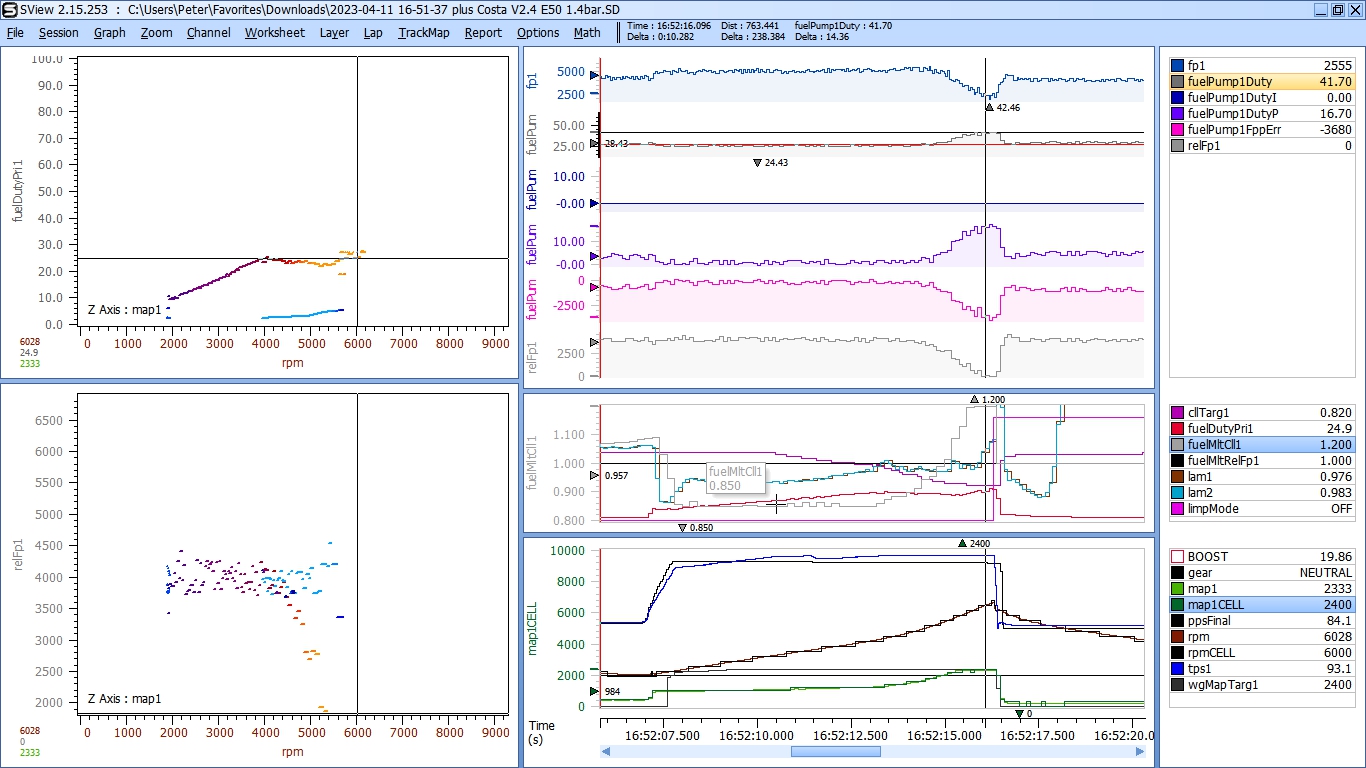

Maybe this is your problem with the fuel pump duty not being adequate ?

Re: Port Injection 2.0TFSI
That's a bit strange considering I have fuel pump closed loop enabled with a maximum duty of 95% and my target pressures populated to the same pressures I run on the stock MED9, but I will look through limiters maybe and see if I've missed something sneaky, a 20% correction limit or something. Base duty is 25% across the board. I'll also try raising the base duty to 70% and see where that gets me.

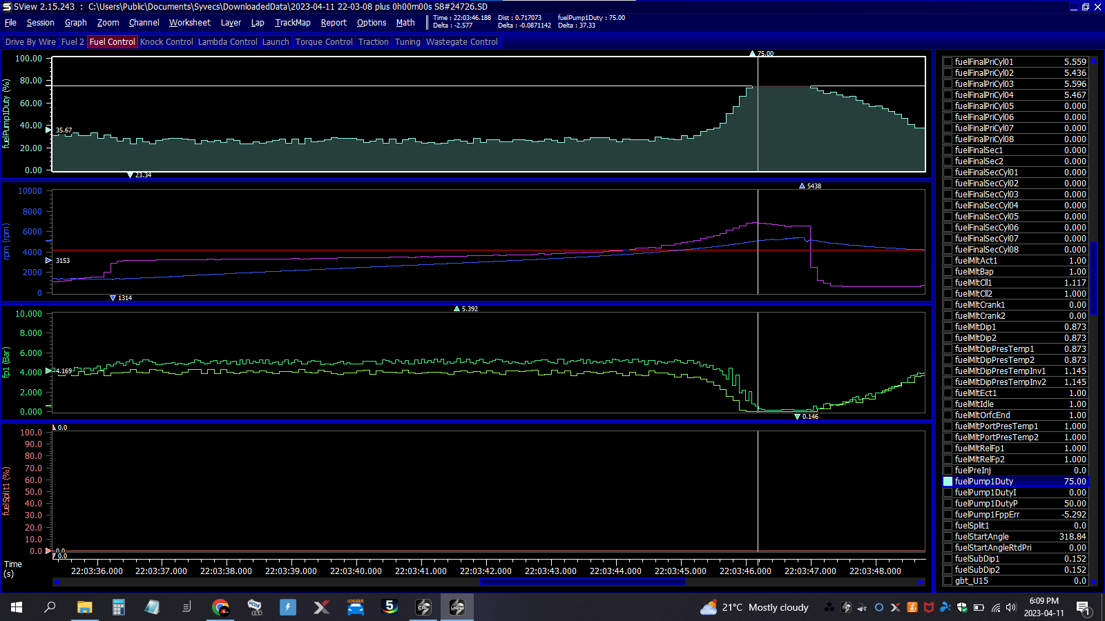

I've got fuel pump DC up to 75% now in the problem area, but seems to be dropping my fuel pressure even faster. Not enough pump? The LPFP in question is a Bar-Tek race pump rated at 800bhp, but not sure now. Lines are -8AN from the pump to the engine and -6 from the reg to rail and -6 as well from reg to hpfp (5 port fpr). New log is attached with increased duty and no split (50% split with this setup triggered a lean limp immediately).
So, as Peter was so kind to point out, the PWM control in Syvecs for the LPFP is inverted. I flipped the p component in reverse (adding up to 50% for positive error and removing up to 50% for negative error) and it's smooth as glass. Until now I didn't find any documentation that stated fuel pump control was flipped, so let the record state!
