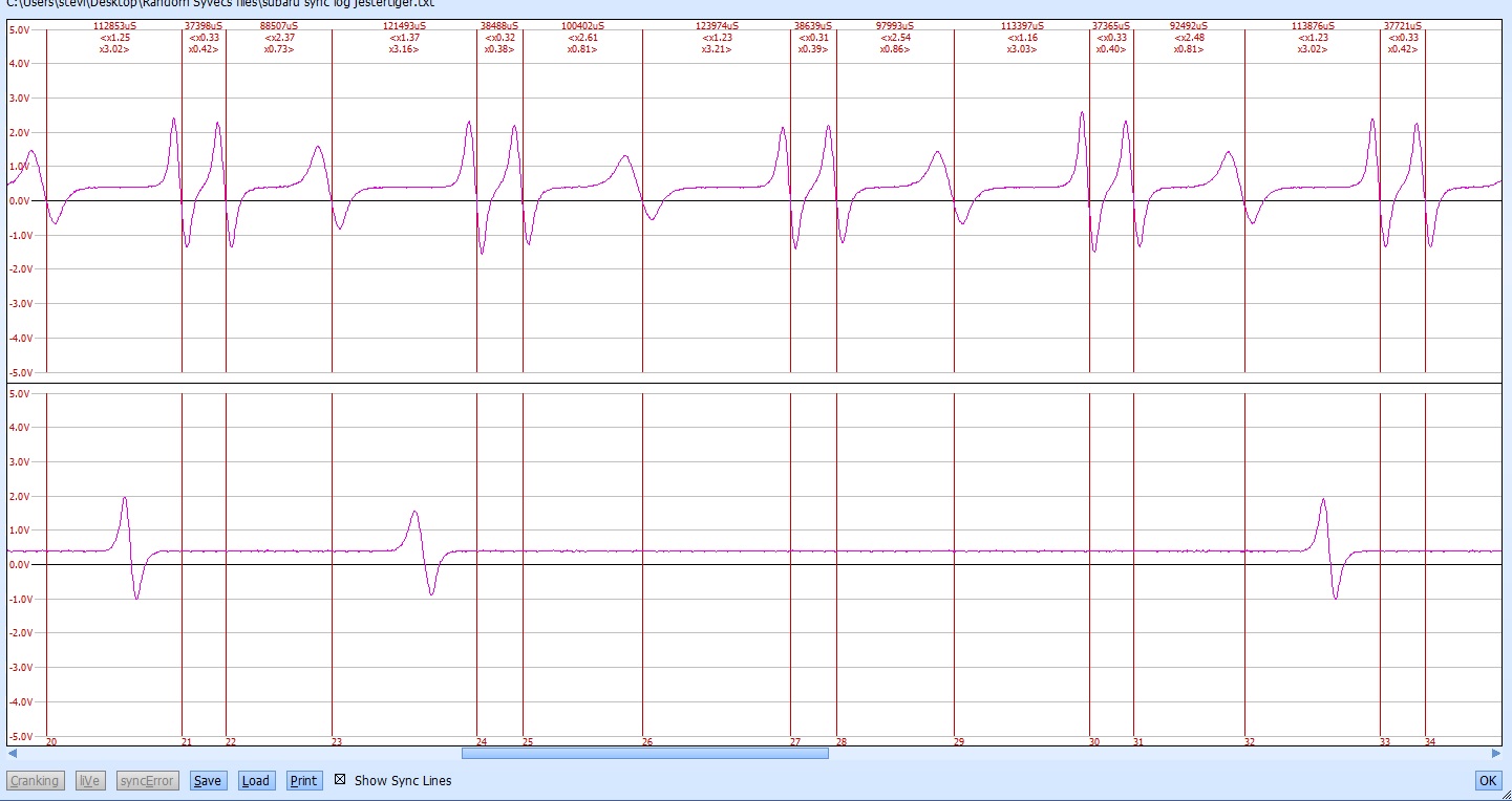

after chatting with the Guru Stevie, he wanted the cal and sync logs. so here they are.
im getting a crank and cam signal now in the software, its setup already as a G11 sensor. the software shows it turning, but wont sync and fire.

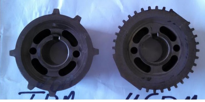

you are using an old 6 tooth G10 crank wheel, with the later 01+ cam wheels with two teeth
You have the ecu crank config set for G11, which is the 01+ 36-2-2 crank wheel. Pic example
subaru crank 1.jpg (51.04 KiB) Viewed 34535 times
Really at this point the best solution is fit the correct crank wheel and you should be good to go.
I'm sure the ecu can be configured to work with the old G10 crank wheel and newer 2 tooth cam wheels easily enough using the manual cam checklist, but whilst yes it is just a software change to do this, the newer wheel with more teeth is simply a better option.
It is not a setup I have run before, and I'm not fully au fait with the crank triggering setup to do remotely, without having it here to actually test any changes I would make. So I cannot change the Cal file to help you.
Whilst it's annoying to have to remove the timing belt etc, I would be doing it and install the correct 36-2-2 wheel. It's just a better wheel.
But your crank and cam triggers themselves are good clean triggers. Just wrong for the ecu config.

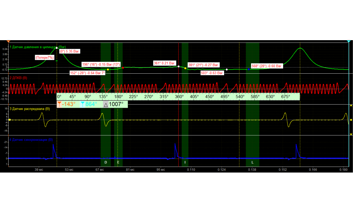

This is effectively what your sync log should look like ( this is an external scope with other data too )
https://rotkee.com/en/wavebase/good-tim ... model=2113

this is what you have.
jester sync log.jpg (224.27 KiB) Viewed 34535 times
