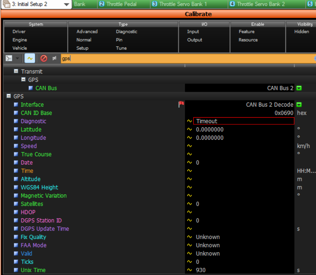

I'm setting up the 100hz GPS to my M150.
Followed the instructions for the MoTeC calibration Setup but it doesn't look like any data is being received.
The car is in the garage (can't be moved) but even if satellites were not being picked up should there be some other values shown?
Thanks in advance.

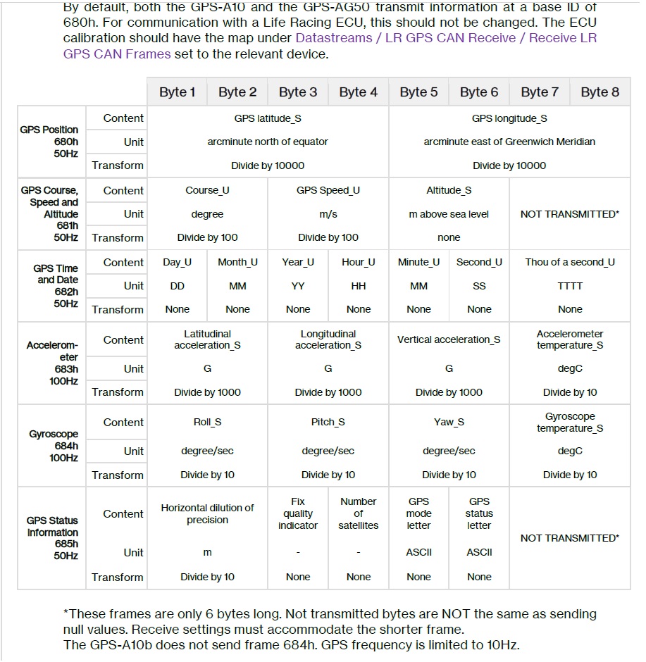

your first image shows CAN base at 0690 ?
Does the GPS stuff not start at 0680 ?

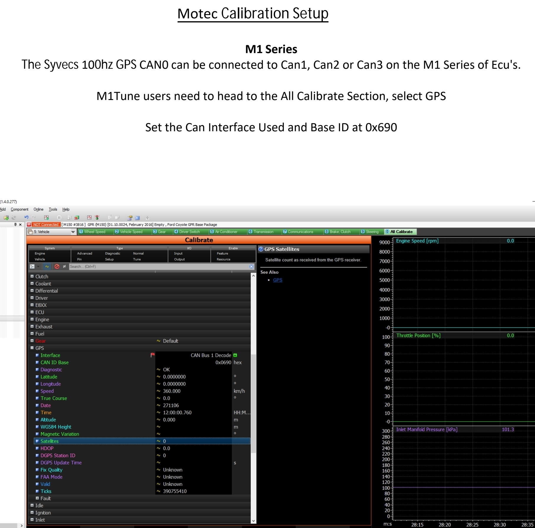

I set it to 690 as per the manual for Motec
- Screenshot_20241019_202542_OneDrive.jpg (670.3 KiB) Viewed 380788 times

Ahh, there are specific instructions.
Not sure then. Certainly mine can pick up a GPS signal in the garage, not great but usually something.
