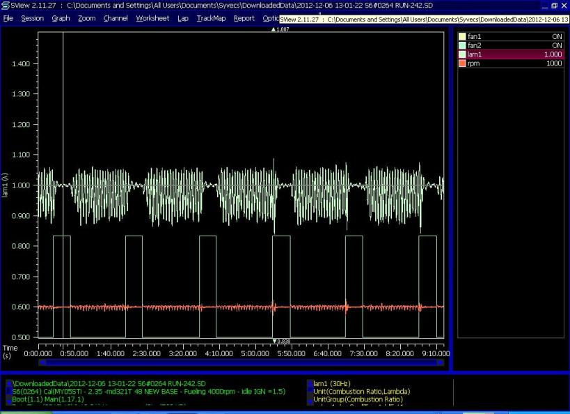

I have AFR oscillations at idle. These seem to disappear and AFR completely stabalises every time the coolant temp reaches the threshold and the fans kick in. When the fans turn off, AFR's start to bounce about again. I would like to have the nice stable idle all the time ... so if anyone can diagnose what is happening here, that would be huge help, as it's got me stumped. :?
Below is a log screenshot, showing what I'm describing ... you can see both AFR and RPM oscillating when the fans are off.
Edited to add - S6Pnp on a modded 2005 STi

Your fuel map and/or voltage compensation is imperfect, and that is the cause of your symptoms, there isn't anything "wrong".
I can see that your lambda goes up and down in time with your RPM fluctuations and this will all be initially caused by greater airflow required to deal with the not insignificant extra load caused by the fans on the engine, via the alternator.
Is your battery voltage also fluctuating? And if so is your injector battery compensation correct at the varying voltages?
Is your injector battery compensation even correct at the nominal voltage? If it's out by a chunk it will exaggerate or dampen changes to the fuelling at idle due to multiplied corrections.
Is your closed loop multiplier going up and down? The closed loop response is something that needs to be "tuned" especially when you look at the integral which can start stepping up and down if you're not careful.
Do more tuning, get it right.

Changing to version 1.25 of the firmware and substantially increasing the closed loop transport delay in the new 3D map available has really improved closed loop operation at idle. I also enabled the new Integral Term Scaling function and reduced the integral values as advised in the firmware release. The oscillations are gone and the closed loop function now works as I would have expected.
Paul,to answer your questions, yes the injectors are ID1000's and I was extremely careful when entering the latencies. Battery voltage fluctuations are small. When the fans kick in, the voltage dips initially, but has recovered within 2 seconds back to 13.4V. The closed loop multiplier was all over the place before, but since making the changes described above it is smooth.
