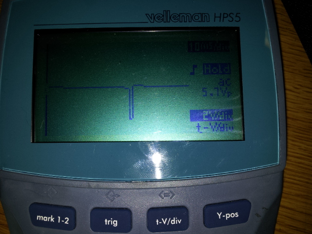

Hi Paul, thanks for your time.
Scope attached of ignition output.

- Ignition Output.jpg (208.19 KiB) Viewed 21603 times

That looks fine on the scope and 2.5ms is fine for CDI.
I would check your CDI wiring and setup in general as I have used the Pro14 with an S8 no problem at all. Check you have a good +12v supply and good grounds for the CDI and all the normal things.
