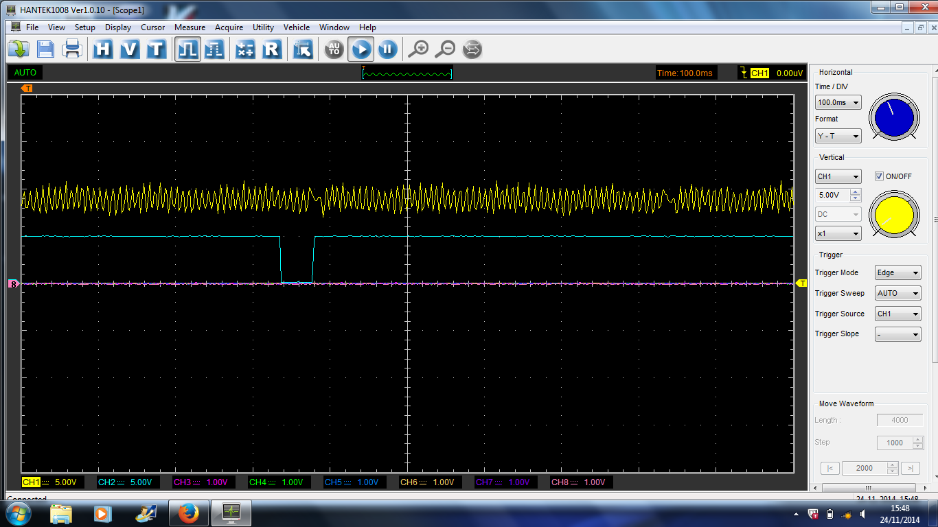

Thanks for the fast reply guys. I know i've got something wrong but cannot see it for looking.
I have attached a crank and cam trace of the signals recieved at the ECU pins. I have check the pin allocation angain and its right.
i have also attached my Cal file so you can see it if there is something im missing? Really dont see the problem but im sure its something really simple!
Re: S8 crank sensor isssues
Not that it matters because you can trigger on a rising or falling edge but the crank sensor has the wrong polarity.
Anyway, I would really need to see the sync scope output to confirm the crank and cam are properly assigned.

Crankshaft sensor was set to falling edge, now set to rising edge due to inverted polarity on crank sensor wires (you can see this in the gap where the falling transition isn't well defined) this will require a timing let to confirm the base timing.
Not sure on crankshaft thresholds as no sync scope trace (which will show the voltages as read by the ecu after being biased to 2.5 volts to read the bipolar signal). HOwever they will often set at rest at 0.3-0.5 volts, so at low cranking speed it may struggle to get down to zero volts, so I've raised that. I've also lowered the high threshold to ensure the output exceeds it at low speed cranking.
Camshaft sensor thresholds set incorrectly. Low threshold set to zero, many hall sensors will never actually reach zero volts.
Camshaft sensor input filter was set to ON, turned to OFF however with the input being on 7 it's already filtered. Due to the filtering I've also set the low and high thresholds to 3.0 volts and the low threshold to 2 volts to help minimise any delays caused by the decay that may result from the filtering. To stop the filtering, move the cam sensor input to inputs 9-16, however for a single tooth it really isn't a problem.
Gap definitions are all okay, but you may want to tweak the max and minimum gap widths if you run it problems on cranking and first fire up.
I also see you have ignition outputs defined but the ignition is set to "Normal". If you are using COP ignition with build in ignition amps you will need to change that to TTL on 1-8.
You also seem to have wired the car in firing order, there is absolutely NO need to do this! Exactly what cylinder is wired to what? Because the firing order is also set, so you need to be sure you're doing both and totally mixing it up.
Cheers
Paul

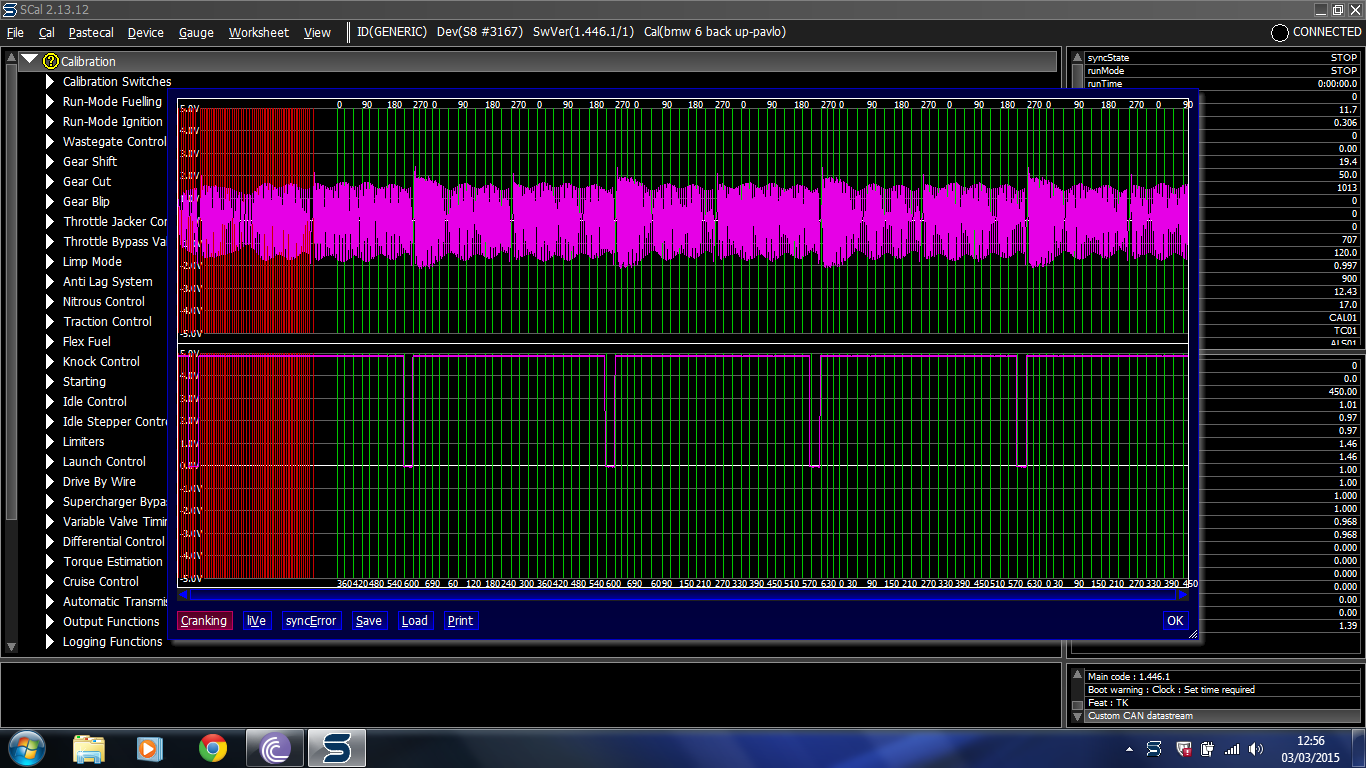

How do i get more inputs in the SyncLog? I thought it was only for cam and crank.
Here is the trace and print screen.
Thanks
Thanks
