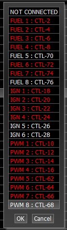

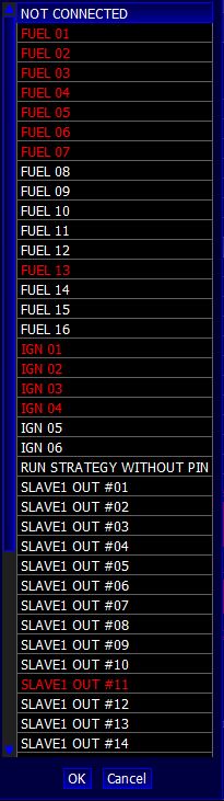

Have the AUX1-8 (PWM1-8) output been renamed FUEL 9-16 in later releases?
Previous versions also gave the control board pin number alongside the output type and number, but in 1.69 I just see the output type and no control board number?
Older version...
Latest 1.69
Cheers,
Jezz.

Funny...I'm on 1.67 and havent looked at this for a long time.
but noticed today my fan wasnt working and checked I/O to do an output test. And it's as you're describing, it just said Fuel12

So I'm guessing that your fan was on PWM4 before, now on FUEL12, Stevie?
I'm in the middle of assigning outputs and I'm just after clarification that this is how the pins have been renamed before something goes horribly wrong LOL.
Can someone confirm that this is the new naming convention?
PWM1 (CTL-10) = FUEL9
PWM2 (CTL-12) = FUEL10
PWM3 (CTL-14) = FUEL11
PWM4 (CTL-16) = FUEL12
PWM5 (CTL-62) = FUEL13
PWM6 (CTL-64) = FUEL14
PWM7 (CTL-66) = FUEL15
PWM8 (CTL-68) = FUEL16
Cheers,
Jezz.
Re: Output pin names, have they changed?
I need to go back to 1.50 for it to have the old numbers, all newer versions say FUEL instead of PWM/CTL
TBH I did notice a change in the software when I did the output test yesterday, mainly noticing it was easier to correlate the two from I/O config to the output I tested
But never though much as to why it was easier.
So the new numbering makes sense within the software, even if it may slightly alter excel/wiring table setups.
I tested my own injectors before and they pull less than 1A ! lol I run 2 per output and they run around 1.7-1.8A at idle although never did test at higher rpm's to see if they maybe drew more current at higher operating ranges.
And looking back correctly...it's PWM06 and FUEL14 for my Fan. Just had 12 in my head last night.
Having the CTL numbers in there is handy too for refering to wiring diagram charts, that's maybe not a great omission.

I can confirm that FUEL9 is AUX1, FUEL10 AUX2 and so on.

A couple of things....
1) Yes, PWM1-8 were re-named as FUEL9-16, this happened when the S6 firmware was enhanced to allow more than 8 injectors and it was simplest to just rename them all - that way you can still choose (max 12 assigned at the mo). This is also more consistent with the S8 naming convention. The CTL numbers were dropped because they refer to pin numbers most people will never use (the 100 pin interface between the control board and the carrier).
