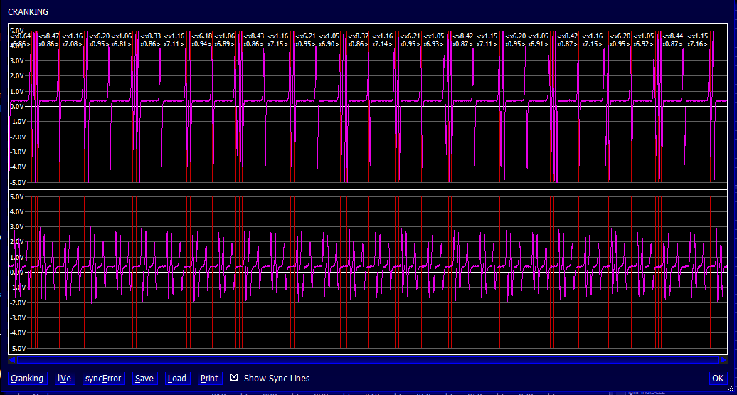

So I got around to attempting to start this morning for the first time - quick look at the sync log and I *think* this is where the problem lies - no (green) sync lines:
I'm assuming I should see confirmed syncing here when cranking? Also noted no fuel smell on the totally dry plugs so I'm guessing no sync so no fuelling...
Car is a v3 Sti Impreza - so using the subaru G10 config.

Solved - cam and crank sensors were reversed!
-Ed.
Posts: 1420
Re: Non starter this morning
Yep, crank trace appears up top, cam down below.
