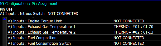

And both sensors are defined in I/O Configuration->Pin Assignments->Exhaust gas temp as per the pic? Sorry if that sounds very basic, but sadly I have no other bright ideas.
S8 EGT.png (8.25 KiB) Viewed 29371 times
