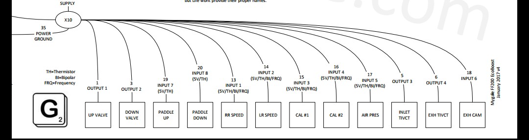

It's all connected up. Unfortunately due to the Formula Ford security on the ecu I can't verify that it's working until I drag it to Northampton Motorsport for the dyno session where they will have access to the Life Hq licence server and will be able to verify it's status.
This is what it's being used for, paddles, launch and ti-vct
- _20170113_064421.JPG (57.74 KiB) Viewed 79650 times
