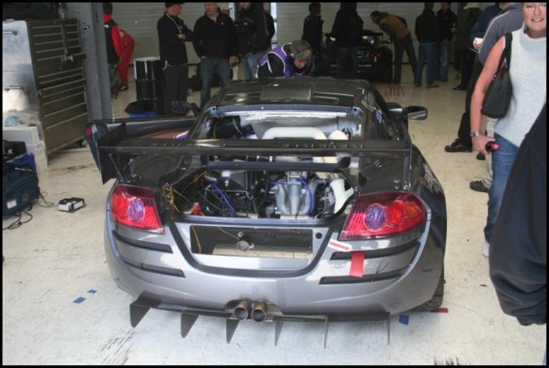

After qualifying 3rd the mood in the garage was upbeat but we knew we'd have our work cut out in the race

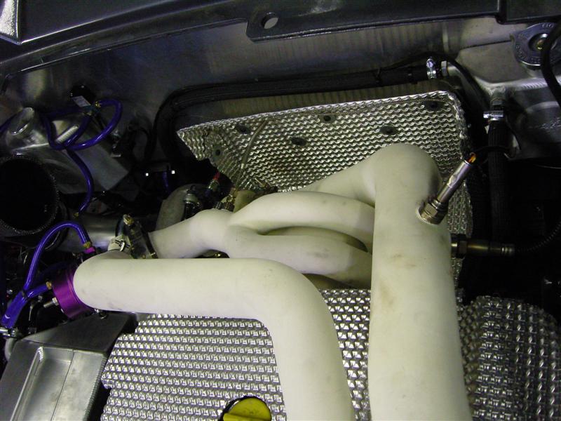

Manifold, Turbo, Wastegate, Exhaust, lambda's and EGT

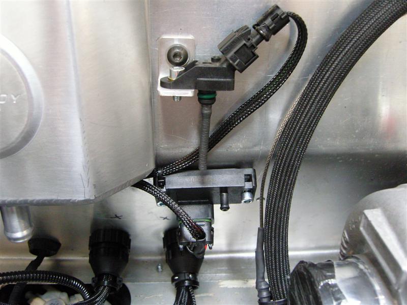

Baro sensor and Map sensor

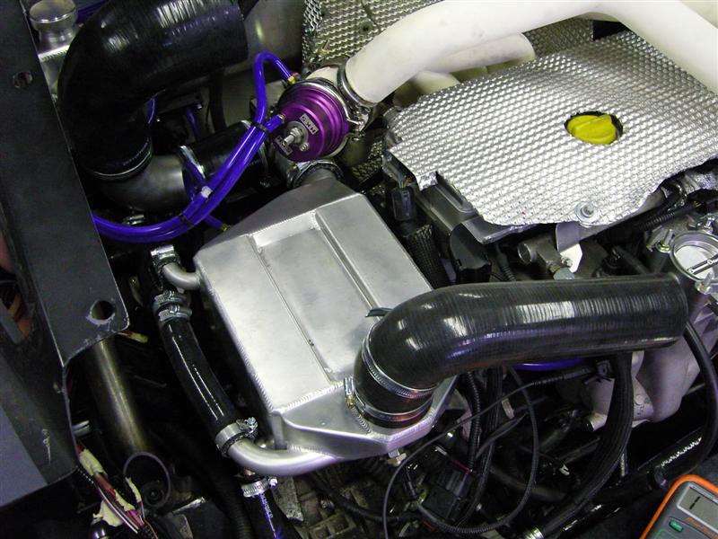

Water/Air intercooler

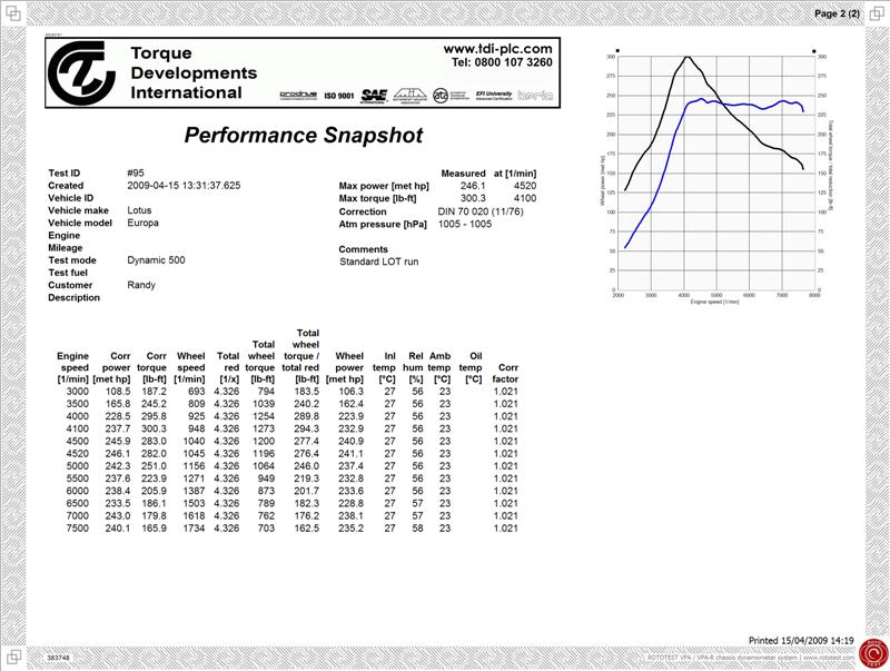

The dyno results, the race series dictate that the ramp rate on the dyno be 500rpm/sec and the class limit is 250 at the hubs. The control of the S6 made maximizing the rules to this extent possible.

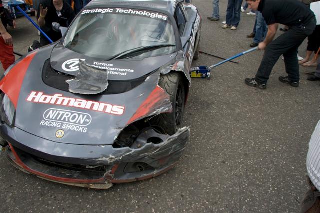

After suffering very heavy damage only a month ago at Brandshatch when our man was "collected" by an out of control Lotus 2-11, the Solaris powered Europa was fully repaired, upgraded and back in the action at Snetterton over the weekend at the annual Lotus Festival round of the Lotus Trophy bouncing back with a commanding win in race-1 followed by a hard fought 2nd in Race-2.
All four corners where completely wrecked after finding the tyres at 70mph+

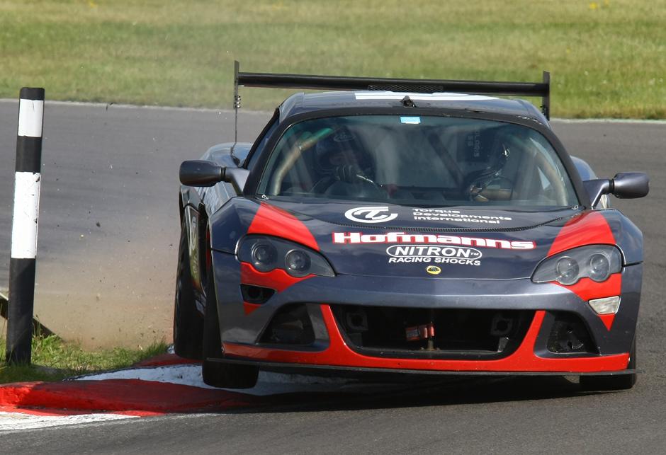

Some pictures from Snetterton

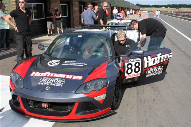

Engine performance is still amazing the driver, the broad range of power meaning that only 4 gear changes where necessary per lap.

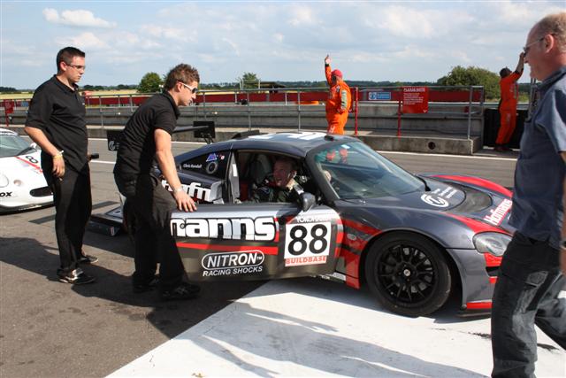

Gathering the data logging

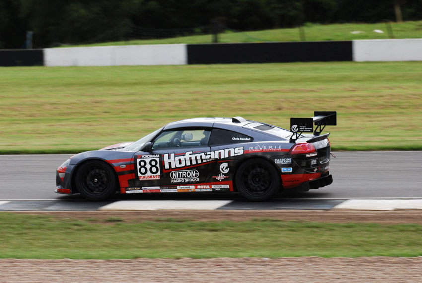

Thought Charlie might like this one,  the Solaris S6 is visible in this shot of Chris pushing on in the Europa at Snett.

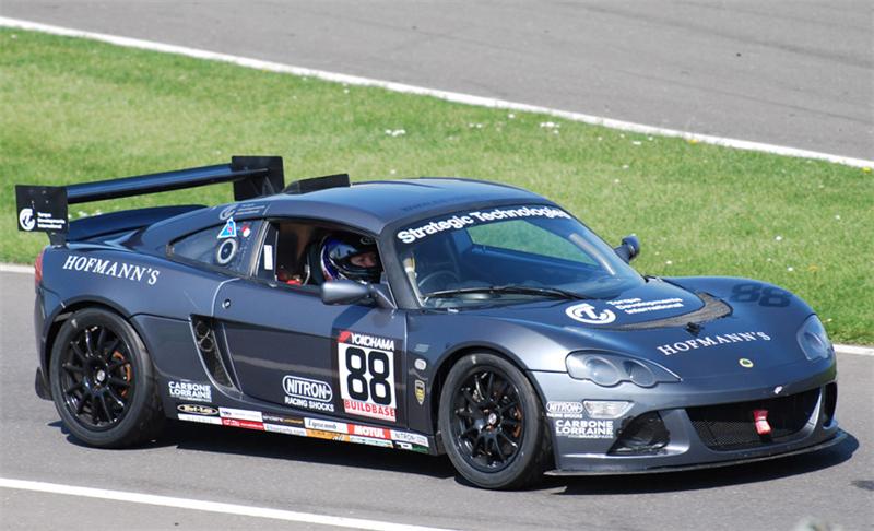

Another quick update on the Solaris powered Europa. This weekend she was in action again at the Lotus Elise trophy meeting held on the GP track layout at Donnington Park.
After careful analysis of the data gathered at Snetterton by both the Solaris and the Racelogic V-box we were able to highlight some area's where significan't improvement could be made with relatively minor changes to the spec and set-up of the car. With all changes made but completely untested we headed to Donnington a little apprehensive, fortunately the data had been accurate and very useful because the car was better than ever qualifying in pole position. We then went on to take a commanding victory in the race winning by over 12.5seconds in 13laps :)
We've made the decision to pull the car out of the Elise trophy now for the rest of the season and will begin to developing it for use in the top class of the prestigious GT Cup championship, our aim is to get the car out on track for at least one GT-Cup round this year in order to assess our strength's and weaknesses vs our competitors and then hit the ground running at the first round in 2010.
One shot from the race at Donnington this weekend.
