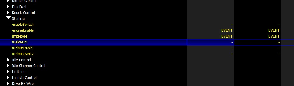

It's actually in a rather odd place now that I look at it lol
Or to find it....Config, Goto Logging item and search for limpmode
But increase the time for a trip to activate to around 1000ms. 400ms could muck up misfires, traction loss or other irrelevant events that arent really lean on load.
