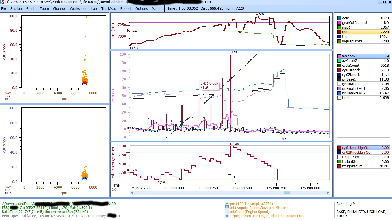

Here is one of the many set up worksheets I use, shows it working and I record every individual cycle of the engine too

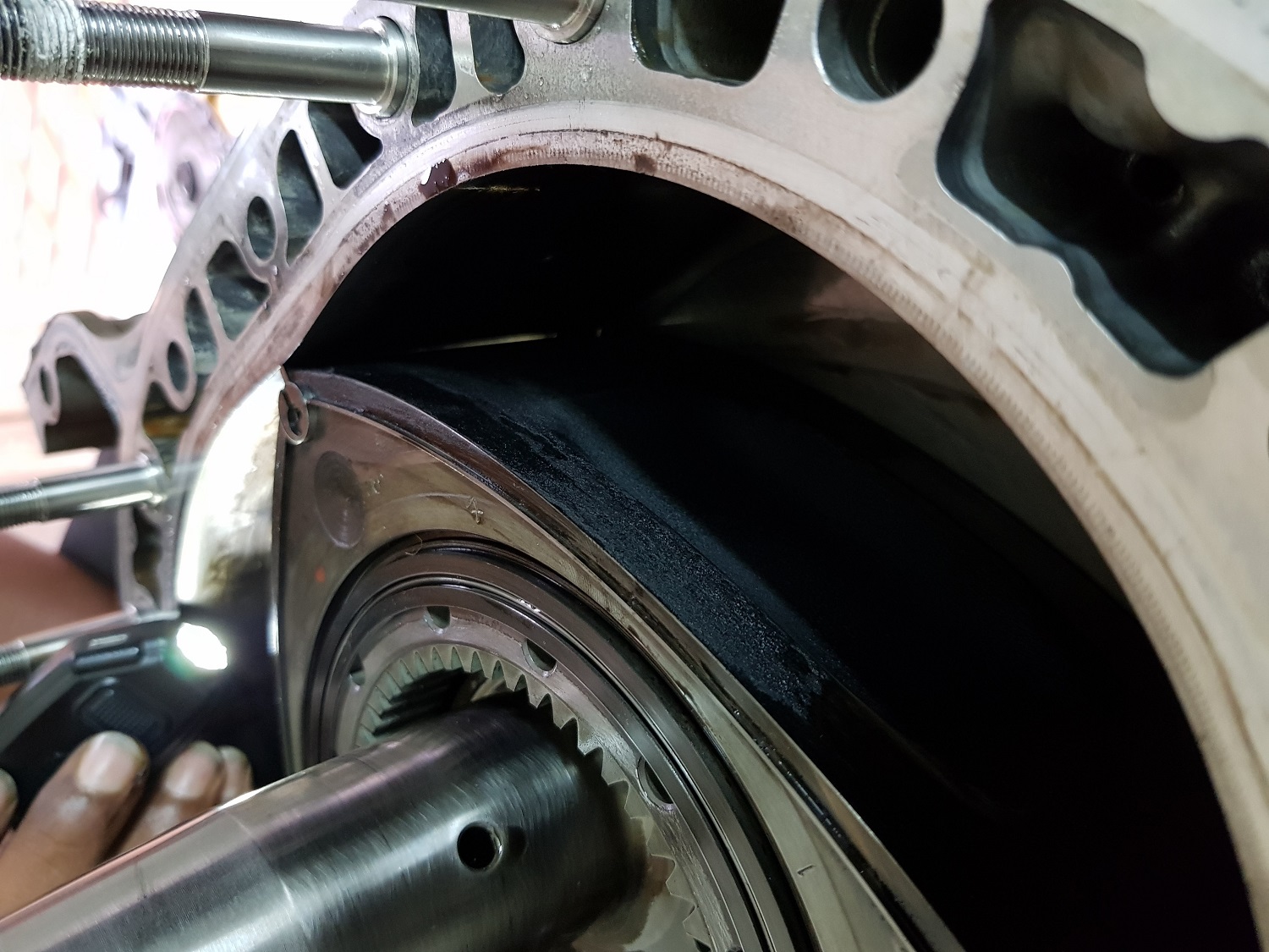

Attached: This is what the run away knock looked like and the root cause of it, again all bare the sub par sealing parts distorted during run in period which cause the hot gasses to leak back into the preceding chamber were totally fine and thus reused. Had another case with the same user who tried another set of equally dodgy parts, lasted a bit longer but again same situation, gas leakage around this time a worn out leading edge causing sever gas leakage and resulting in equally high knock readings, and again the pre ignition event trigger saved any further engine damage.
p.s. Seen the same thing (gas leakage) happen in various piston engines which results in the same high knock readings which then lead to pre ign or super knock events. Shown up during leak down tests, and again thorough initial set up of the knock control system prevents any further damage happening to the engines. It's the best thing about the Syvecs that you really can make the engine live through what on inferior offerings would have resulted in the whole motor being a bin job.
- screenshot.2 (3).jpg (602.71 KiB) Viewed 42566 times
- gas leak out of control knock.jpg (415.95 KiB) Viewed 42567 times
Re: Ignition Advance When Knock Control Active
Thanks for the update!
In the picture of the rotor, is that something melted onto the rotor, or has the actual rotor melted a bit there? Bit dark to tell in the picture on my computer is all?

- Posts: 538
Nothing melted, pic shows light passing through where there should be no light (part failed) so gap between seal and outer housing.
