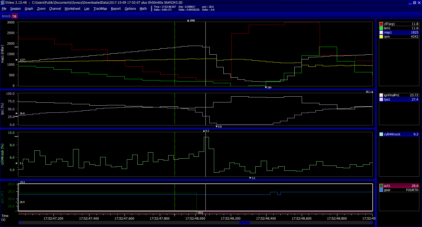

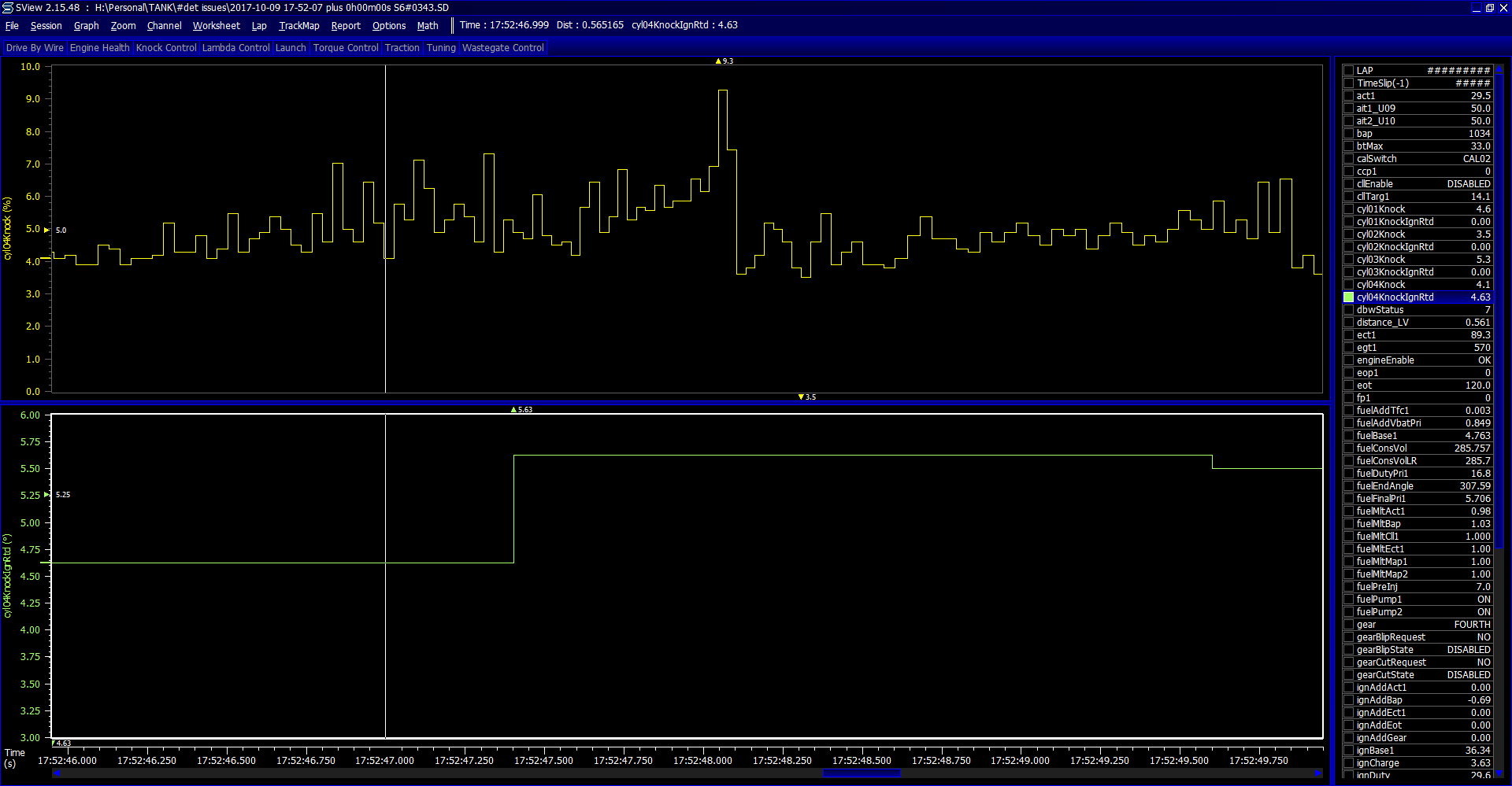

Hi all,
Any advice on whats going on with silly (1/2 throttle, low-ish boost ) ignition retards? (cel light - as thats set to 4 degrees).
Looks like its occuring on lift off but also it has already occured (not captured unfortunatly) and still retarding Cyl4 before the larger spike.
Am i just too high on gain ?
thanks
Steve

Re: Ignition retarding
Screenshot tells little.
Cannot see logging rate, cannot see base timing, cannot see whether knock control is doing much other than that on 4 etc etc It would seem the threshold has been clipped for this retard to happen, but we cannot see where your thresholds are set.
As for how any timing appears ( in seconds, not ign timing ), again logging rate can vastly affect what you see on screen when trying to relate things together.
In short, not enough info.

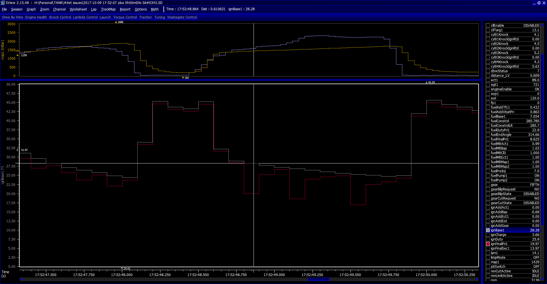

Same file, screen shot for explaining what i mean @17:52:48
Dropping ~10degrees for a reason i cant see ! maybe this is the logging not fast enough to catch indiviual cylinder changes? Could be cyl 4 with ~6 knock retard and -2 cyl correction ? no wonder its not happy - hardly smoth
Whats the general idea of retarding each cylinder -2 degrees (cyl4), where others are 0 ? Just more det prone?
thanks
Steve
thanks
Steve
- ignition.png (77.5 KiB) Viewed 82937 times
Logging rate for "knock" seems to be 1000Hz, very good for listening.
But most of the retard that is in place, has been in place long before that particular log. But in general all cylinders seem very quiet ( yes gain and other settings can affect that though, but I doubt there's a problem ) . Where the additional retard is occurring, and boost/rpm etc...it's probably nothing at all and just the base knock threshold tables need lifted a little on that cylinder.
Not sure what parameters are available to the restoration of timing with the basic after things have gone quiet again though. I only ever used the basic years ago on a friends and it did exhibit the same behaviour, but we upgraded to the full knock to give full control over the removal and then restoration of timing.
But some engines through design, some might feel some cylinders want a little more or less fuel, or a little more or less timing. That's up to whoever is tuning it and how things sound/feel at the time etc and based on the engine/build.
Would you actually feel it pulling 5, 6 deg etc on a single cylinder ? probably not.
it is showing final ign timing much lower than base in a few other random areas, but it isnt logging anything that would identify why it is doing that that I can see.
