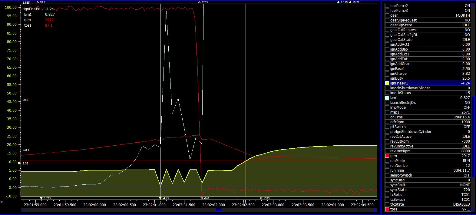

After I wanted to vote on the highway, I noticed that the engine is sporadically jerky in high gear ratios and bangs out of the exhaust.
This can also be seen at the lambda LOG (see picture)
Fuel table and ignition table fits, does not ring or somewhere is missing.

which I also just noticed that the ignition goes to minus, however, do not find the correction that changed the ignition value

Yes, the engine is completely original and the Syvecs are completely pnp for this engine.
the syvecs should actually record all parameters or not? or can I adjust what you want to log?
I think it is in ignition parameters but I find unfortunately nothing.
because in the picture for example, one sees that the ignition goes to minus

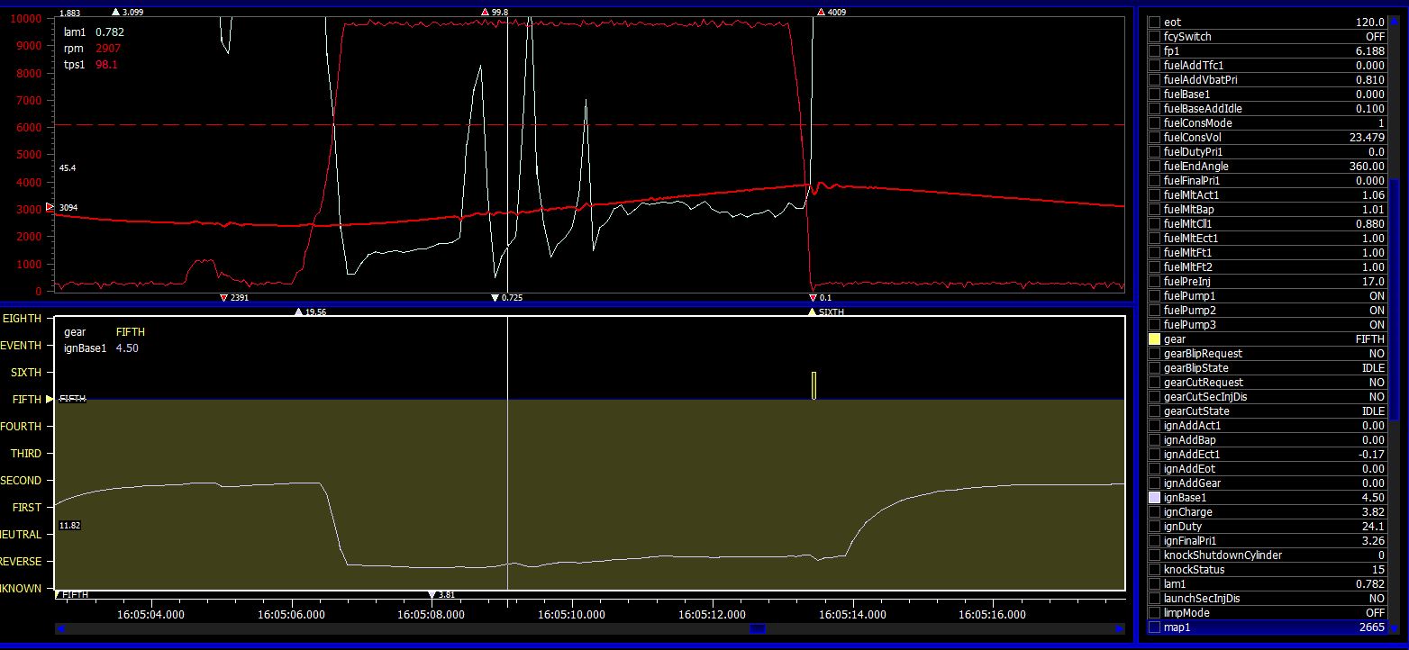

in the appendix still a picture

Re: s8 tfsi engine jerky
Read the manual.
Yes you need to select the logging parameters
Use Scfg to do this
Use Scfg to do this
SO the log function I have now synonymous adjusted, the fourth cylinder has knocked.
I was just having a look at the log, and when the lean spikes occur, the Knock logging gets triggered, although it doesn't show any cylinders being cut. However, knock control seems to be retarding the ignition.

Slowie wrote:I was just having a look at the log, and when the lean spikes occur, the Knock logging gets triggered, although it doesn't show any cylinders being cut. However, knock control seems to be retarding the ignition.
He isnt logging anything worthwhile to tell what knock control is doing.
