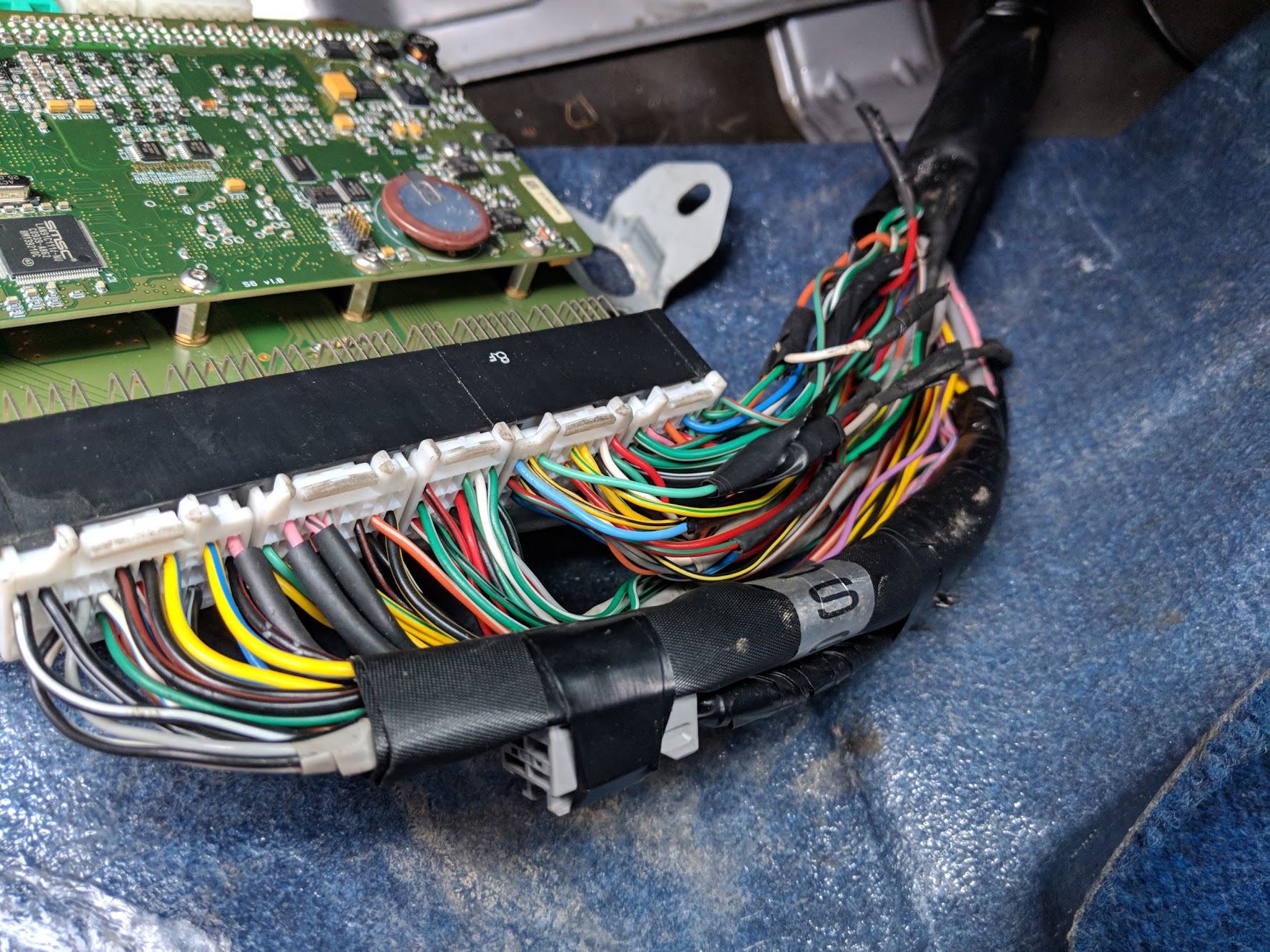

On the advice of my mapper, I am fitting the two wire Bosch wideband knock sensor. The stock sensor is a single wire and I've followed the colour back to the ECU. I assume this is where I connect the signal wire from the new sensor? Where does the other wire go? I apologise for asking the same question in two places but I just want to be sure, and this is the last thing I need to connect before going for the remap.
The connector furthest to the right has a red/blue wire which I think goes to the knock sensor.

- Image of my ECU
- MVIMG_20171108_125605.jpg (589.84 KiB) Viewed 55222 times

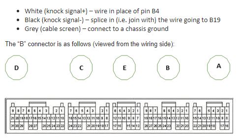

Courtesy of Tim from JT Innovations:
Re: S6PnP Subaru Impreza Knock Sensor Input
CAVEAT EMPTOR...my A/B/C/D/E labelling does NOT MATCH the labelling in the S6PnP pinout section of this forum!

Tims - Syvecs
A = D
B = B
C = C
D = A
E = E

Thanks again Tim, after I cut the loom open a bit I found the original knock sensor wire exactly where you said, was easy to spot as the shielding was just sitting there connected to NOTHING.

Engine-side, it's joined to an earth joint block elsewhere that also serves the MAF, O2 sensor grounds etc. ECU side there should be a connection to the screen (somewhere!) that goes to B22 - not sure if B22 is internally connected to chassis ground or if there's some kind of pseudo-balanced input stage designed for noise rejection.davidmcluckie wrote:Thanks again Tim, after I cut the loom open a bit I found the original knock sensor wire exactly where you said, was easy to spot as the shielding was just sitting there connected to NOTHING.
