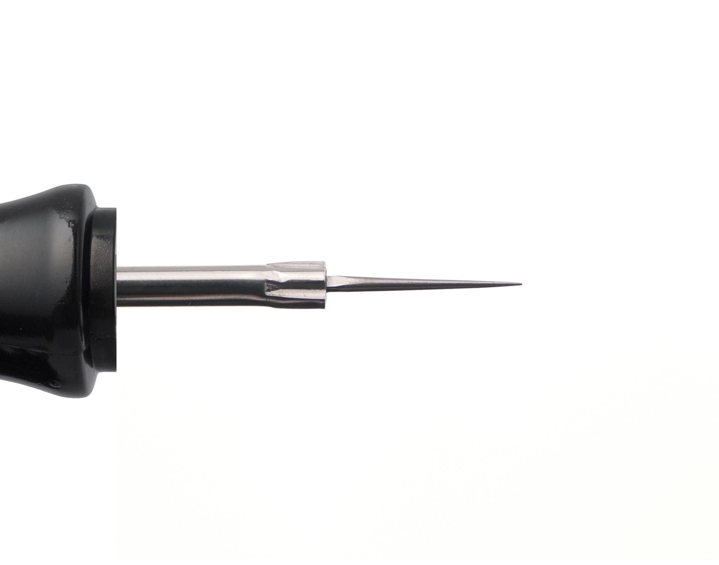

I don't think they all fall out - never have for me! Unless you dismantle it completely. I have always still needed a tool to remove them.
The tool is inserted into the connector block from the mating surface so you can push the small tab in. It then pulls out easily. I have a "proper" one from TGS in Germany - it looks like this:
